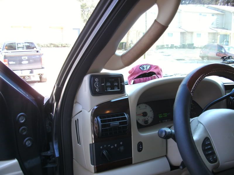

Added Edge Insight electronic gauges.
Yea! Love my gauges!
Gauges told me shit was broken. I fix it.

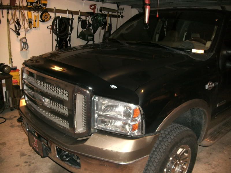

How she sits as of now. 08Feb11

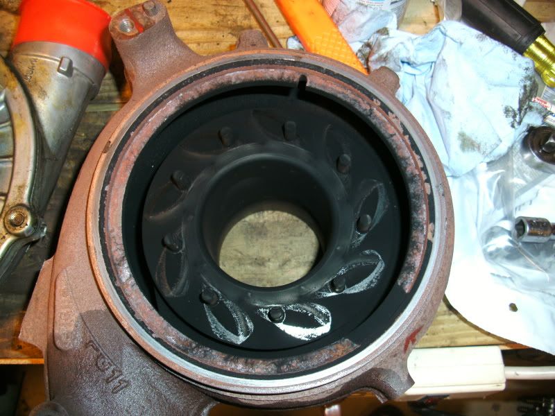

The turbine exposed. You can also see the way the VGT works. Those little fins move and open/close to allow/restrict the exhaust flow to the turbo, effectively making it a anysize turbo from minimum to maximum. Smaller turbos spool at lower speeds, bigger turbos at higher speeds. This is the best of all worlds.
Turbine housing. You can see where the lobes were actuating. This turbo is actually in pretty good condition and I only did this because I had it out and had the kit sitting in my garage for about a year.
Part number for a new unison ring. The unison ring is what actuates the lobes.
New unison ring installed and lobes cleaned up. Looking good.
Cleaned up turbine housing.

New Nitto Terra Grappler 33" tires.

I also bought a Edge Insight CS to monitor all my shit and so that I don't have gauges everywhere.
